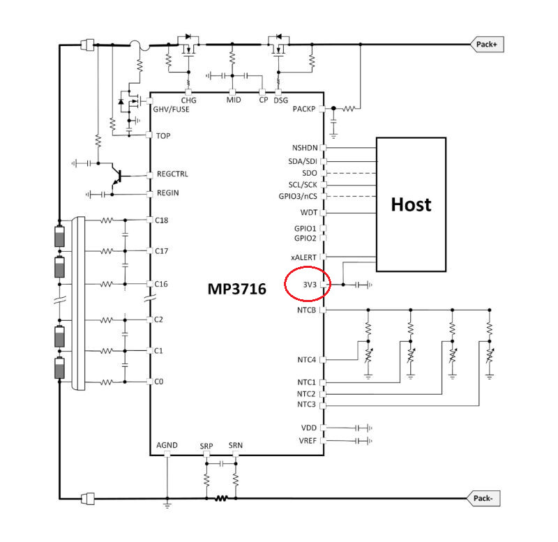

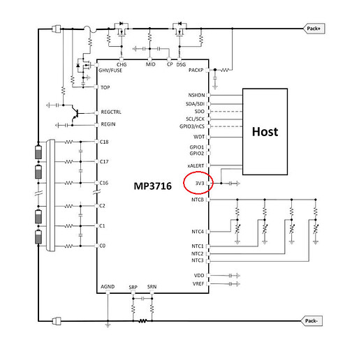

Hi @friedl ,
If possible, I’d suggest using the newer MP371x family (which covers 3 to 8s, 3 to 10s, 3 to 16s and 3 to 18s).
All of our AFEs include LDOs for powering an MCU:
The LDO can be configured to stay on when the AFE is asleep just for this application.
Best, Will
