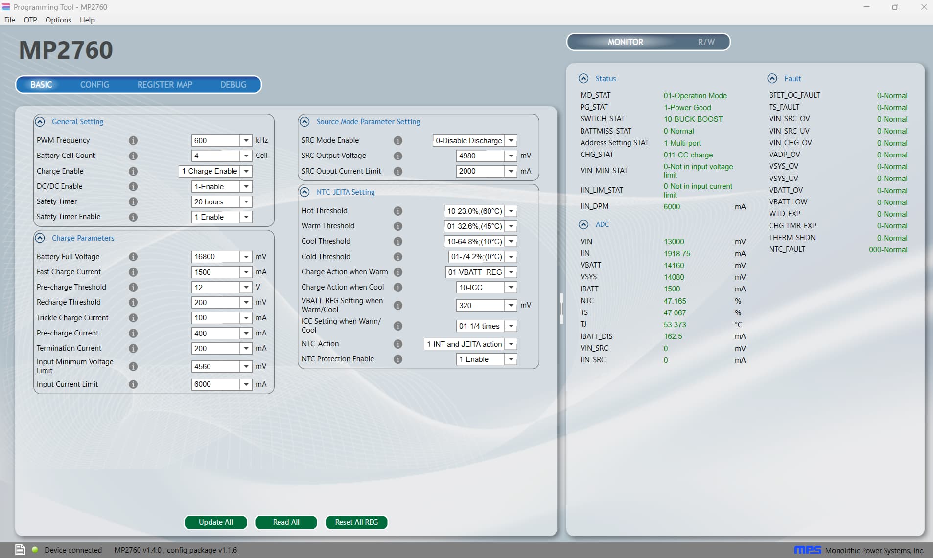

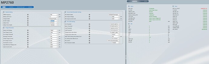

I have been evaluating the MP2760 battery charger. From it being fully working at one point, something happened to the dev kit and now it is always returning a BFET_OC_FAULT. I don’t know how to fix this fault, Any ideas?
Just to add, the BATTERY_OC occurs when there is no input voltage and system voltage is generated from VBATT.
The BATTERY_OC clears when i connect the VIN, but the battery does not charge even though the battery voltage is less than 15.5 volts, for a 4 cell Li-ion battery.

What is the software version of MP2760 GUI you are using? I replicated the test conditions you shared and didn’t see the BFET_OC_FAULT error on my end.
Hi.
I have managed to get rid of the error. I will continue testing. Thanks for your support.
