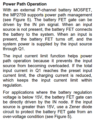

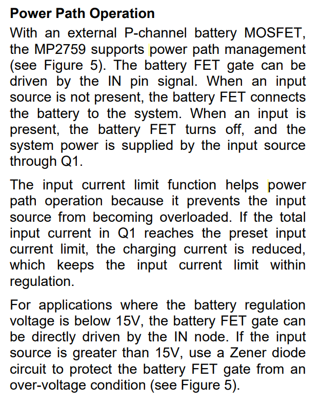

Does the powerpath control external circuitry also work on the MP2659? like it does on the MP2759? It looks to me that that will work…
Hello,
The power path management is more explicitly implemented in the MP2759 as opposed to the MP2659. In short, yes this should definitely work.
Here is more information on that from the MP2759 datasheet:
