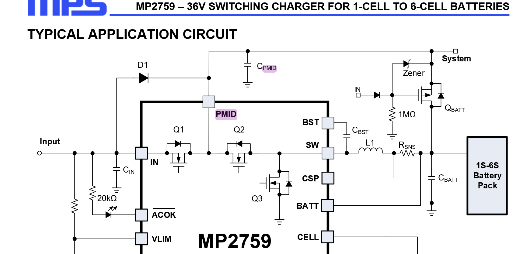

In MP2759 Datasheet, it is stated:
Selecting the PMID Capacitor (CPMID)
The PMID pin capacitor (CPMID) serves as the
buck regulator’s decoupling capacitor. A
ceramic 2.2μF/50V capacitor with X5R or X7R
dielectrics and 1206 size is recommended.
Do not put additional capacitance on the PMID
pin. Connect a 2A/40V Schottky diode in an
SMA package from IN to PMID
What disturbs me is the “Do not put additional capacitance on the PMID pin”. Since the PMID is connected to SYS, does that mean that i cannot add bulk capas on SYS ? If so, why can’t i disconnect pmid from SYS (i have a 4s system with powerpath). How can i add capas down the SYS line (for exemple if i have bucks down the line) ?
thanks for any explanation
Hi,
This just means that you do not need additional capacitance close to the IC for the PMID pin. The PMID capacitor is for local decoupling. Bulk capacitance for other converters can be added within your system further down the line.
Best,
Tyler
