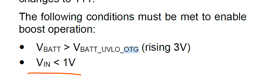

I’m using the OTG function of MP2723, it can charge my smartphone, only when the smartphone is turned off, otherwise the charging is stopped. I see it’s because of the VIN

You are suspecting the phone is providing too high of an input voltage, have you confirmed this with a measurement?

For me it’s difficult to check the voltage output from the smartphone. I just observe this phenomennon: since Iphone will turn on when it reachs the minimum battery level, after the iphone is turned on, I see no charging any more, if I manually turn off the Iphone, the charging starts again. Also tested with Android phones, it’s same. Then I go back to the datasheet of MP2723 and find this.
