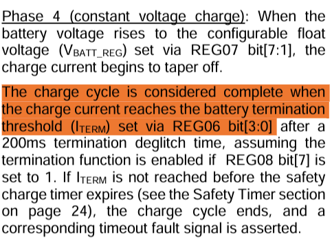

We are having an issue with the MP2723 that when the end of a battery charging cycle is reached (charge current at 0mA) we are not getting the CHG_STAT bits of REG0C to indicate “charging complete”. Are there any other register settings that are required for the CHG_STAT bits to indicate charging complete?

Can you confirm if the battery termination threshold was met?
Can you also verify charging STAT indication?
