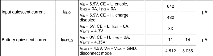

We use a MP2667 for BMS with a 3.6V Lithium Zell. Charged with 5V.
We found out, that the MP2667 takes ~100uA when it ist in Battery mode.
Is that normal?
In the Datasheet I see max. 14uA
Do you have any idea to bring the supply current down?
Best Regards,
Sebastian
Hi @s.reger,
Is anything else connected with this chip? Please isolate the device and verify the same.
The above shown values are the lowest for this device.
Thank you
Saurabh
