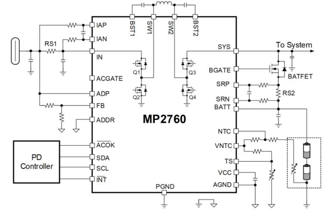

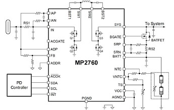

Are you looking for power path functionality from MP2639B? Meaning that Vbus provides power to other devices while also charging battery. I do not think this part has that functionality. Please provide a drawing showing where the “output voltage” you are looking for would be.
An example of a part that has the described functionality is shown below. The MP2760 describes this on page 27 of the datasheet
