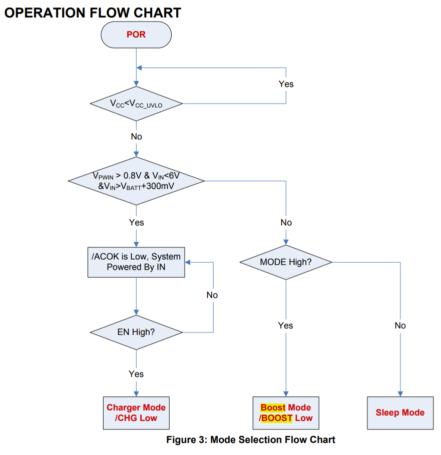

I would like to use the MP2636 in charge mode and boost mode and not switch between the 2 modes.
best regards
Hi vitor.perez,
Sorry, that is not possible. You can only operate in charge or boost mode.
