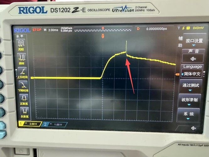

Mp2625b不供电问题(5v电脑电压输出触发断电保护)
使用锂电池:523450-1000mAh

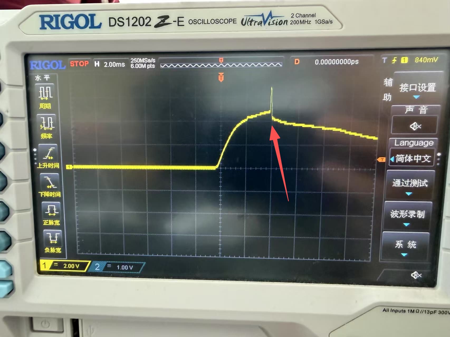

表象:设备插入电脑Type-C接口瞬间,产生一个大约6.3V的瞬间尖峰,触发电脑断电保护。
出现问题:产品连接电脑(5V电压输出)使用Type-C接入的瞬间会看到看到产生一个尖峰,导致触发电脑过压保护,电脑无法给产品供电、给电池充电。
想和原厂、大家请教是否有什么改进方法可以根本解决该问题
Hi @ivy.c ,
Can you please provide the following items:
  1. Schematic (or confirm if your schematic is same as figure 11 typical application in the datasheet).
  2. Your input voltage range and output voltage/current.
  3. Your system load.
  4. Waveform of input voltage, input current, SW pin voltage, inductor current, and output voltage.
My initial assumption is that there’s excess inrush current, so a quick fix would be to increase the input capacitance.
Thanks,
Rubas
