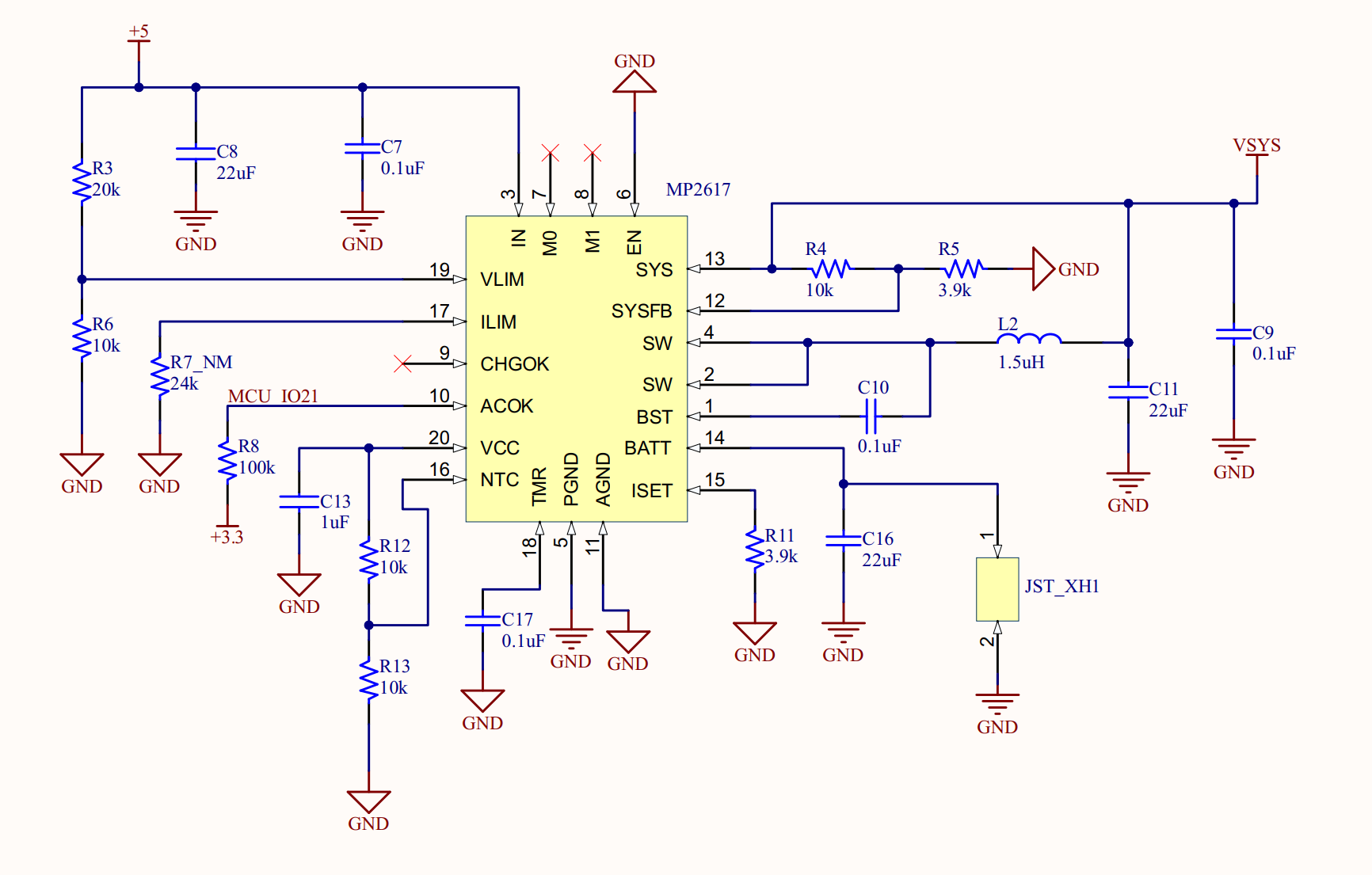

Hi,
I am using MP2617 with SYSFB resistor divider (R4 = 10kΩ, R5 = 3.9kΩ) to program VSYS = ~4.1V
Observed behavior:
  • VIN = 5V (adapter only, no battery connected)
  • VBATT = 0V (no battery)
  • VSYS measured = 3.5V
Question:
  1. Does MP2617 ignore SYSFB programming and fall back to minimum 3.6V regulation when VBATT < 3.4V, even if SYSFB pin is connected (not floating)?
  2. Is a battery required for SYSFB-programmed VSYS to work correctly?
Can anyone help me? I am in urgent need of assistance.
