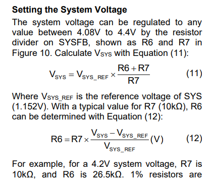

I am using the MP2617HGL-Z battery charger IC. According to the datasheet, setting a resistor divider of 28 kΩ (top) and 10 kΩ (bottom) should configure the regulation voltage to approximately 4.3 V.

  1. To start with are you referring to the resistor divider at the SYSFB pin? if yes then have you tried using 26.5k instead of 28k

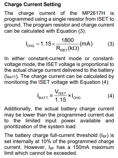

  1. Can you kindly let me know what resistor value you’re using at the ISET pin to program charge current ?
