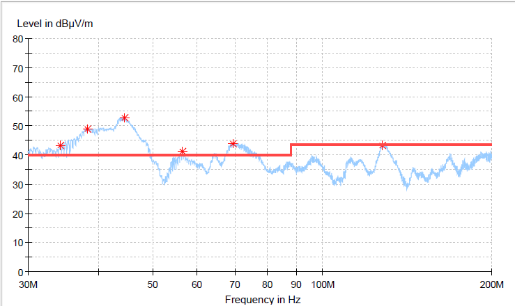

Hi I’m using the MP24881 IC in one of the LED driver application. When I have check Radiated Emission Test then my driver getting failed around 50Mhz Frequency. When i saw the Waveforms then ringing is present while switch on & OFF.
Can any one give the proper guidance regarding the same.

This is likely an EMI problem. Can you show me your waveform for EMI testing, as well as, the settings for the EMI testing?

Yes Sure.
Please find the attached Image.
Thanks for attaching the image. I am working on getting the recommended EMI performance for this part.
