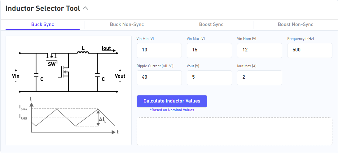

Also, we do have an Inductor Selector Tool available in our website which can help you select an inductor based your Electrical requirements.

Thanks so much for the prompt reply and confirming my assumption that the MPS inductors are acceptable substitution for my use case. As far as input voltage goes, our target is 9-15V input (there is an external OV/UV/RP protection circuit in front of the input of the MP2233 and I had actually used simulation tool that MPS provides online (and tried out different values) and it seemed that 1.5uH was good for my use case - I also believe that I looked at the inductor selection tool that you posted but I will circle back and confirm. to In the event I need to change the value, I like the fact that the MPL-AL4020 series has higher values in the same footprint that will still handle the output current I expect so I think i have enough flexibility in my design.
