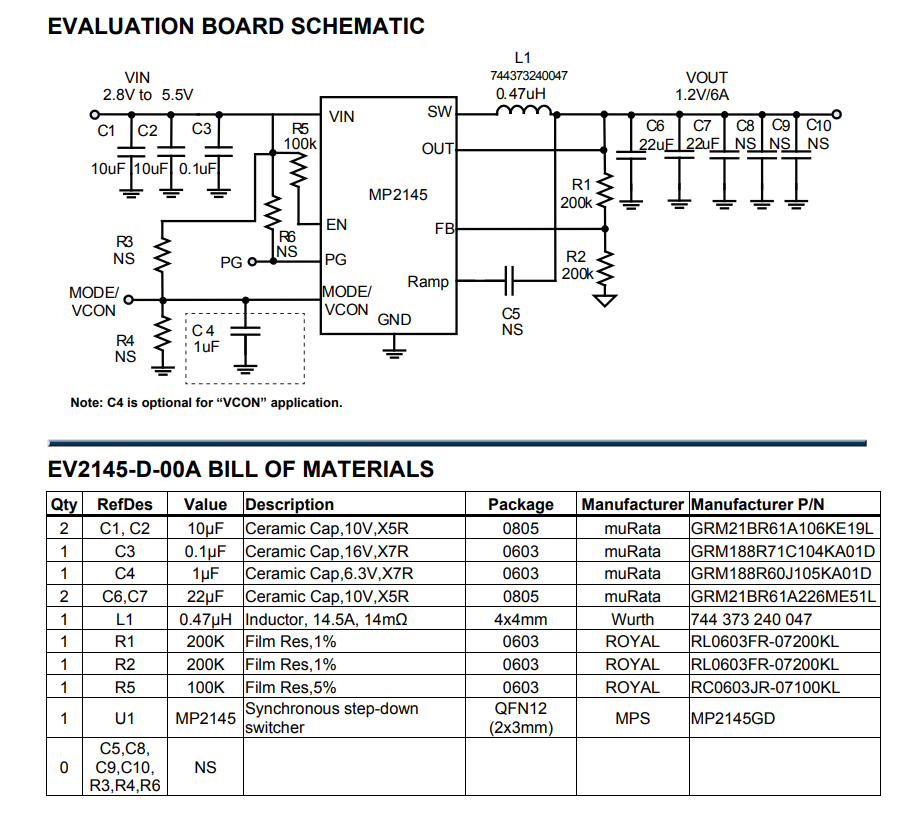

MP2145 is a normal buck converter, you can use to power your LED depending on the voltage it is rated for and it can be set with the two feedback resistors at the output. This part can output from 0.6V to 5.5V.
Please refer to the below schematic from our EV2145: for your reference.
Regards,
Adhish

The MP2145’s feedback loop is specifically for voltage regulation. For a constant current source, you need a chip with a dedicated current sense pin. Using a separate constant current driver would be a much more reliable solution for production.
Hi Angus,
We have MP2480 that you can take a look at.
Regards,
Adhish
