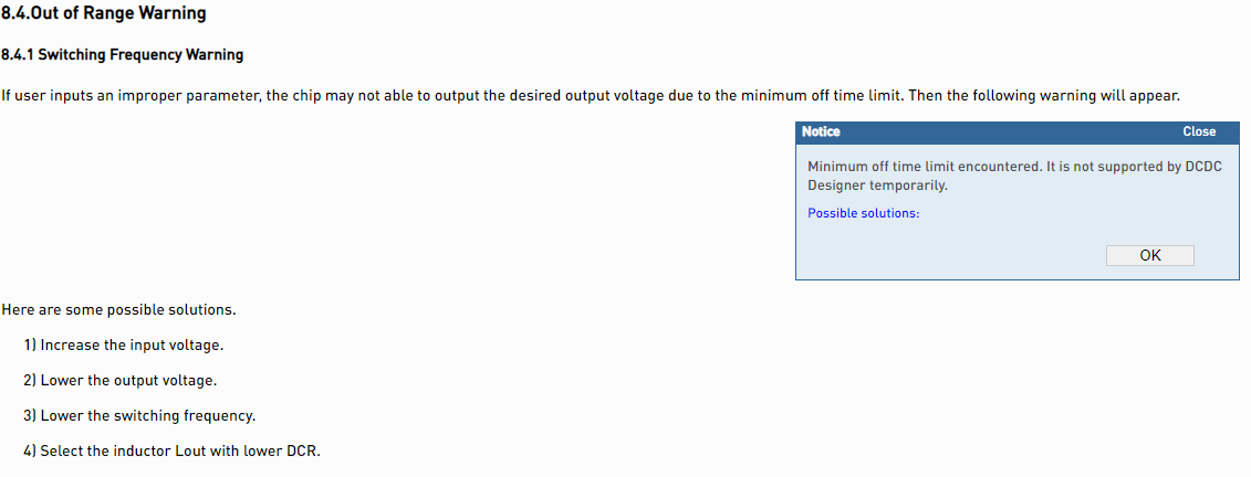

When using design tool Off Time Limit is reached
Is that off time required for bootstrap recharge?
I do not see the point of being 100% duty cycle if off time is required (sory for my lack of knbowledge on DCDC…)

Yes, both of the MP1601 / MP2141N are capable of 100% dutycycle. One of the main advantages is lower RDson for MP2141N.
Regarding off-time, I believe you referring to min-off time. This is accounted for in high dutycycle operation.

What would be then the expexted behavior at high duty-cycle, between 90% and 100% duty-cycle, how do the device operate?
Appart from the 100% line in the abstract, there is nothing describing the behavior, and "the dcdc design tool raises min off time error.

There are certain points to consider for the high duty cycle operation, I was referring to dead time between fets, however, we can hit limits of the device based on how the external components are sized and what frequency the device is operating at.
