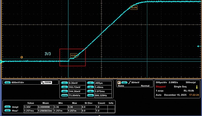

MP1495 exhibits a 144mV step during initial power-up
After investigation, it was found that the step-up stage is unrelated to the BOM of the DC-DC chip’s periphery. It is preliminarily suspected to be related to the DC-DC chip itself. We request clarification on the specific cause of the step-up issue and whether it can be optimized through loop adjustment or soft-start optimization.
