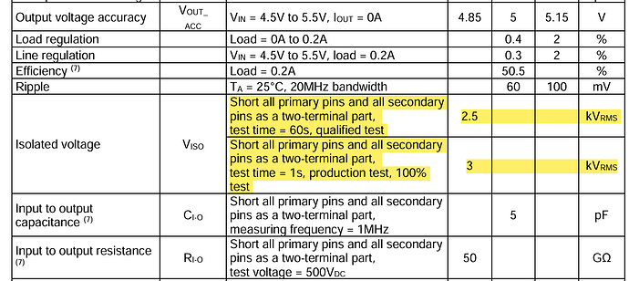

Could you please provide a continuous working voltage for the MIE1W0505BGLVH-3R-P / confirm that its isolation is sufficient to withstand a continuous voltage differential of 600VDC?
Best regards,
Matthias Zöbl
Given the following Isolation Voltage parameters tested at 1s and 60s, then I believe you should be ok with a 600V continuous isolation voltage.
See the follow specs from page 4 of the module’s datasheet:
