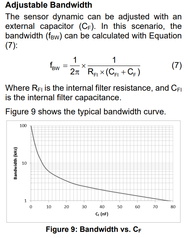

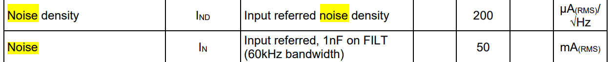

As for noise, it is certainly related to bandwidth. Here are the following specs stated on the datasheet and some information regarding this from the datasheet:
The noise vs. bandwidth tradeoff can be adjusted through capacitor Cf between FILT and GND.
(where CFI = 1nF)
