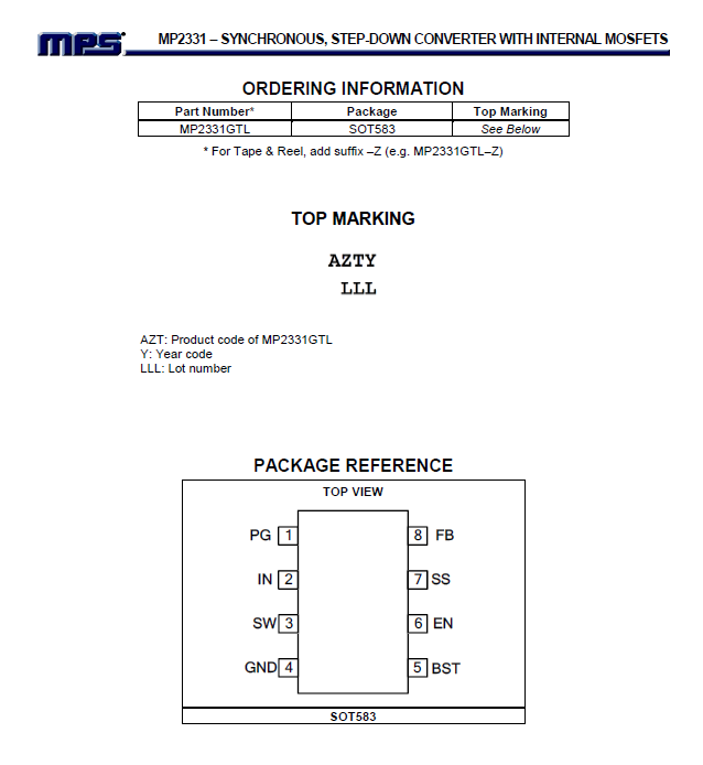

Hi @harrimansat,
The device is MP2331; AZT is Part code; Y is single digit year code; LLL is last three digits of the lot code
Thank you.
Saurabh
