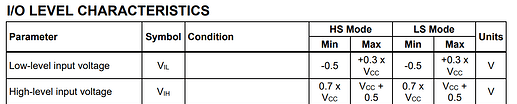

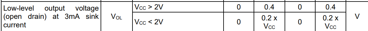

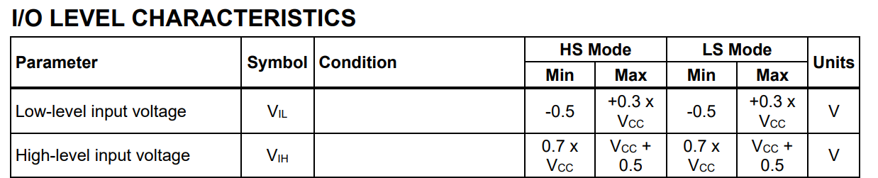

When the MP8870 I²C bus is operating at 1.8 V, could you please provide the corresponding I²C logic thresholds, specifically:
(SCL & SDA) VIH (Input High Voltage)
(SCL & SDA) VIL (Input Low Voltage)
(SDA) VOL (Output Low Voltage)

Hi max1,
Please find the below the values from the datasheet:
