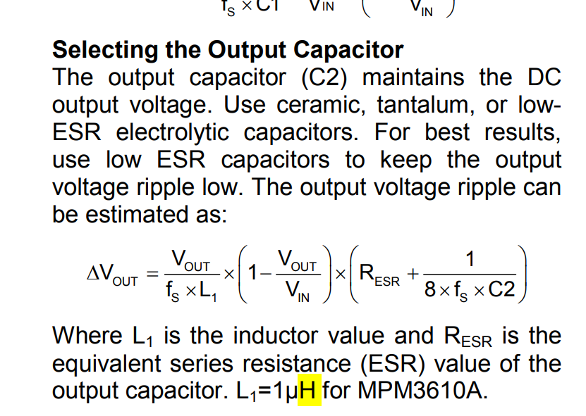

I require the inductor value to calculate the value of the output capacitance.
Equations 5 to 7 in the datasheet (pages 15 and 16) require the value of the integrated inductor, L1.

It seems to be hidden in our datasheet. I will see if we can get this put in a location where it is easier to find.
Hi Eduardo - Thank you for the prompt reply. Apologies, I have a typo in the part number. I am afger the value of L1 for MP3510A. I have double checked the datasheet, and it certainly not found anywhere.
Hello,
The inductor value is 2.2μH for the MPM3510A
