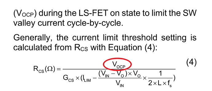

I have question about calculating Rcs value of MPQ8626.The datasheet provide a equation for calculation.But I don’t know what is Vocp? So how to calculating the Rcs, please give me some guidance.
Thanks.

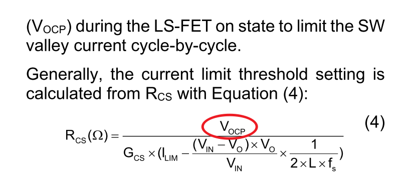

Thanks.
Hello @cosmo_bp,
In the datasheet below that equation it mentions that Vocp is an internal 1.2V reference voltage.
