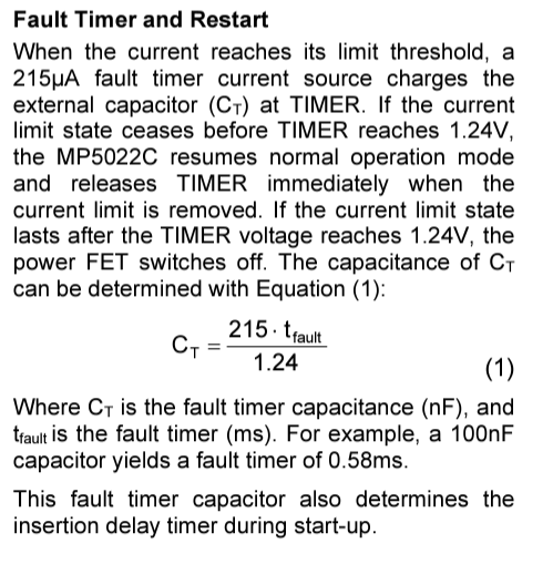

for MP5022C, how to calculate the CAP value of Timer, is there any formula can ref? thanks.
HI @Jim2020,
Please refer to the image below:
Thank you
