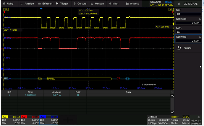

i want to read/write the device but i could not get the communication working.
I have checked the SCL/SDA signal @R11R11/R12 and i measured it on Pin1(SCL) Pin2 (SDA). Everything seems fine but i do not get any acknowledge from the device as you can see in my screenshot.
I tried all possible device addresses, different clocks (100kHz in the screenshot) but no success.
Maybe you got any idea.

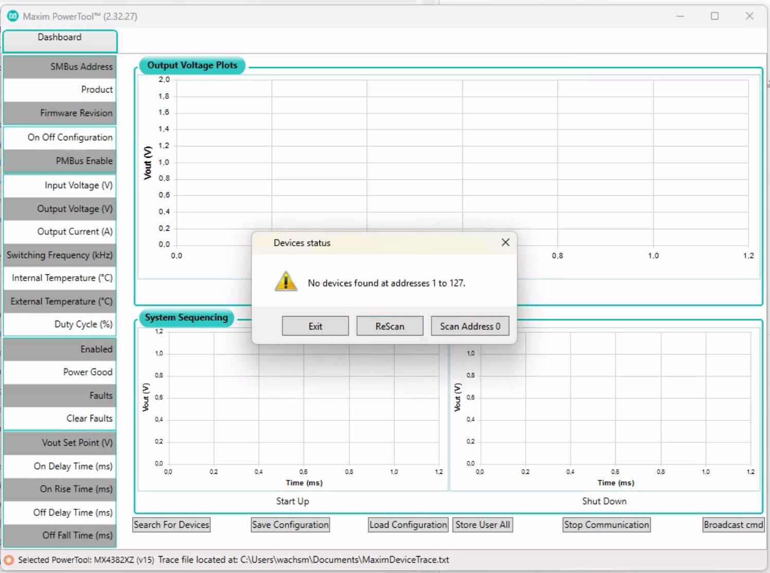

I also did a test with a Maxim Powertool that does a scan on the bus:
Maybe my devkit is broken?

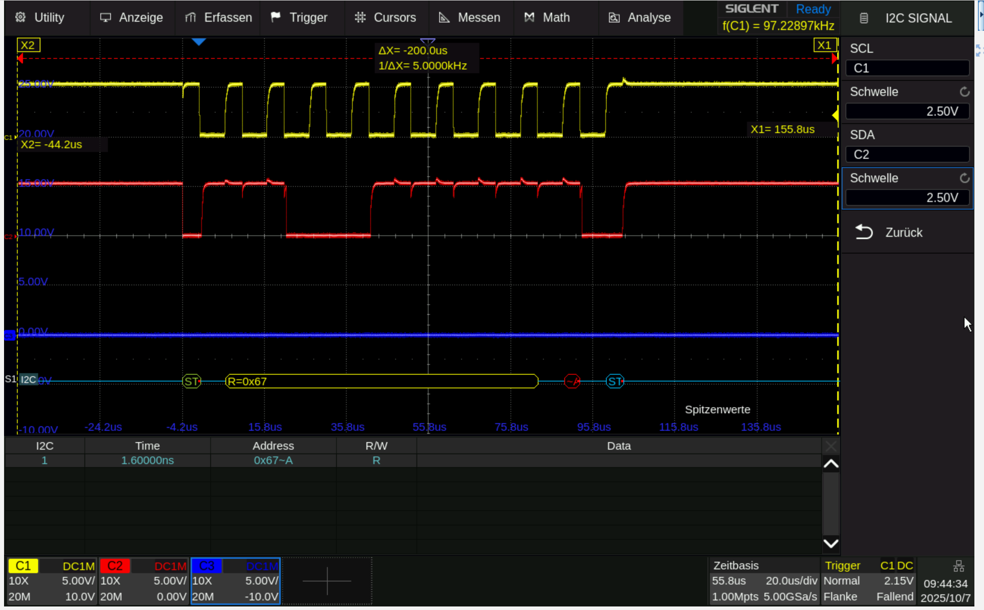

found it:
The SCL pin was not soldered. (hopefuly you can see it)
