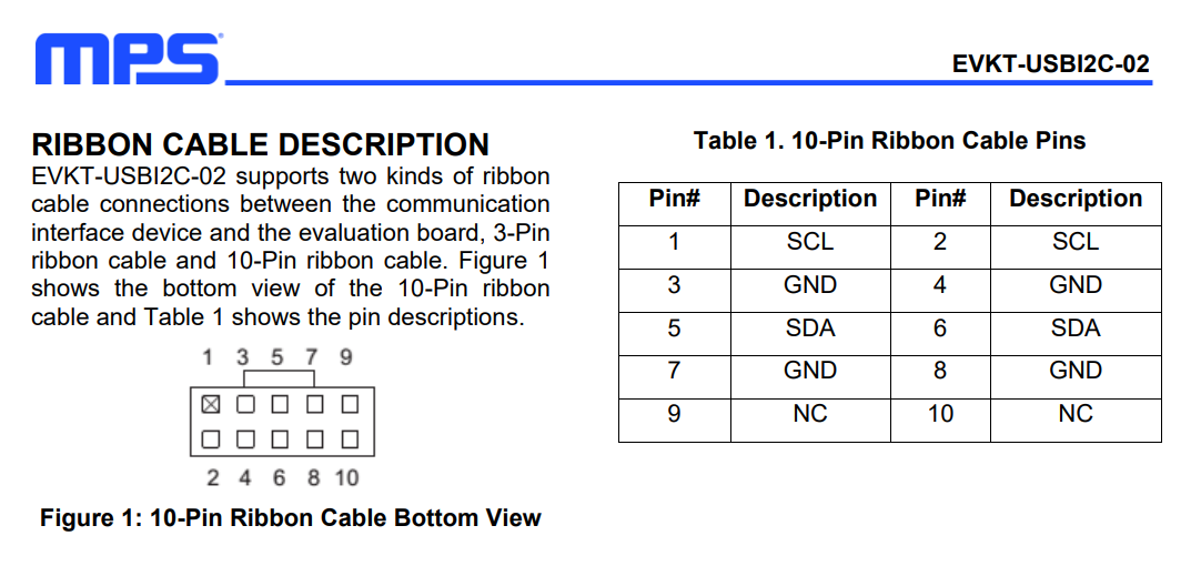

  2. Double check the connections from the IC to the input ribbon cable. Here is an image for your reference from the EVKT-USBJ2-02 datasheet:
