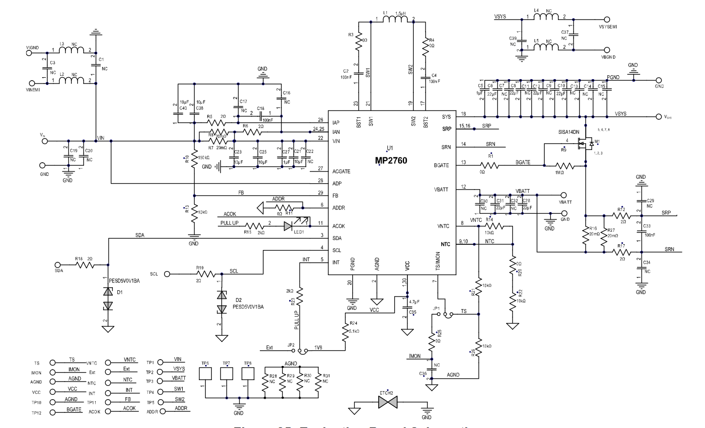

Hello! Just a quick question, on the EVKT-MP2760 there are these 2 ohm resistors and I was wondering what they were for. Are they supposed to be 0ohm jumpers?
Hi @arielle.h ,
R5, R6 and C18 are being used as a termination scheme to improve signal integrity of the sense lines.
R12/R17/C33 as well.
Best, Will
Thanks! How about R18 and R19?
R18/D1 as well as R19/D2 are ESD protection circuits for the I2C lines.
