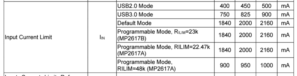

The ILIM = 3A is out of the range specified in the EC table given on page 6.
Please select one of these as per your application.
The real CC charge current is not the setting value, it varies with different input and battery voltages. Please refer to the “Setting the charge current” section in DS.
