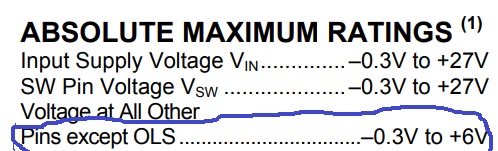

In datasheet of MP1517 below is mentioned:
Regulator On/Off Control Input. A logic high input (VEN > 1.5V) turns on the regulator,
But what will be EN Pin maximum voltage ?
and also explain Pins except OLS…–0.3V to +6V
MP1517 sc
Hello arvind.kumar,
the max based on this line in the datasheet is most likely 6V. I recommend not using 6V. As you pointed out the logic level for input high voltage for enable is 1.5V so going that high is not needed.
