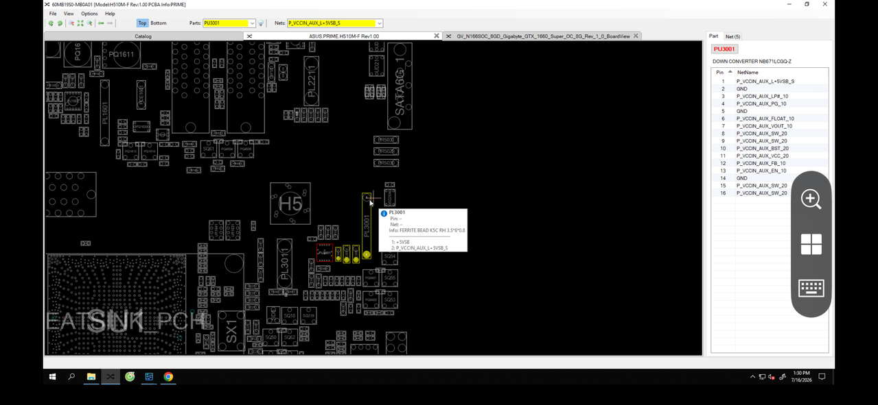

I found that the NB671LCGQ-Z on my ASUS H510 motherboard is shorted on Pin 1.
