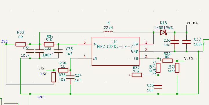

Hello I’m using the MP3302DJ-LF-Z to power a 4.3 inches LCD display. Can you give me 2 or three references for the coil inductor L1 to use.

Are you familiar with our Inductor Selector Tool?
This is a design tool available in our website that can help finding an inductor used for DCDC converters, including Boost (sync and non-sync) topologies.
I would recommend giving it a try using your design parameters.
