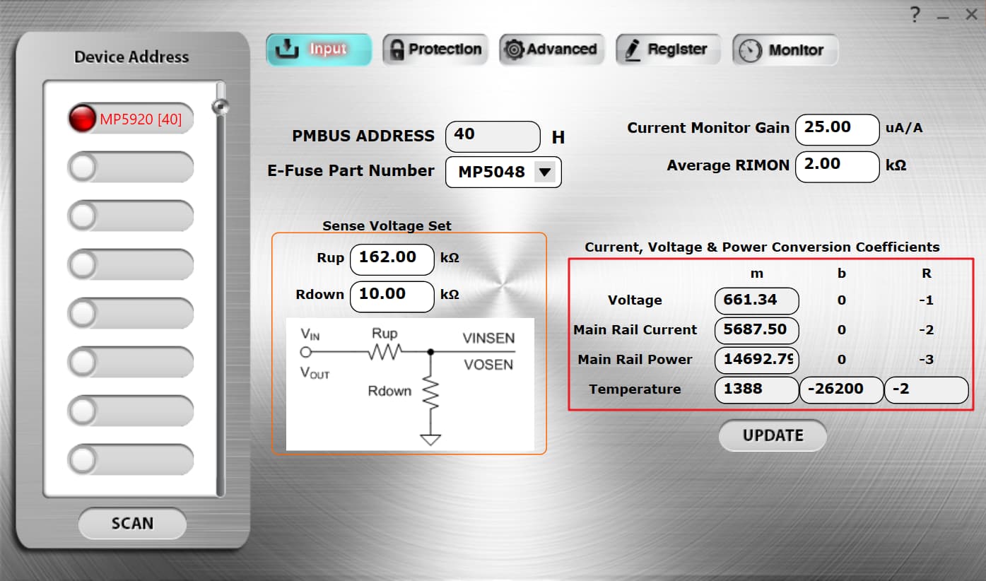

Please refer to the red block below; the m/b/r values depend on the sense voltage, the current gain and Rimon data.
This interface is provided by our GUI.

Please share the link for this version of the GUI.
We are using 4.4.6 of Server telecom core power monitor programming GUI.
We neither see the temperature m b r values in this nor the efuse selection dropbox.

What are the m, b , r values of temperature dependent on? We have a later version of the GUI, which doesn’t show m.b,r values for temperature. Are they same for all MP 5048?

We tried with the GUI version provided by you. We still dont see the m, b, r values for temperature.
