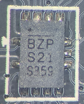

I’m trying to decode and find the datasheet for a component marked BZP. I’ve found that it corresponds to NB692FGD‑Z, but the marking AYK also seems to refer to the same NB692FGD‑Z, which is confusing. Are BZP and AYK actually the same part?

BZP and AYK marking codes correspond to different parts:
  • BZP- NB692FGD (8 Amps)
  • AYK- NB692GD (6.5Amps)

So, those two have the same pinout right? Is it possible to get datasheet of NB692FGD?

Correct, both NB692F and NB692 parts are P2P.
The NB692F datasheet is not available in our website. However, If you need to access this datasheet please fill out a ticket using the following link:
