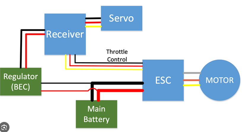

We have a general block diagram for drones which can be found here.
Thank you
