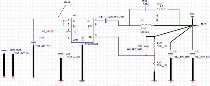

Hello,
Could you please confirm if it is acceptable to add an RC snubber in parallel with the output inductor, as well as a 100 pF capacitor at the input of the MP2322GQH, as shown in the attached screenshot? Do you have any objections or concerns regarding this implementation?
