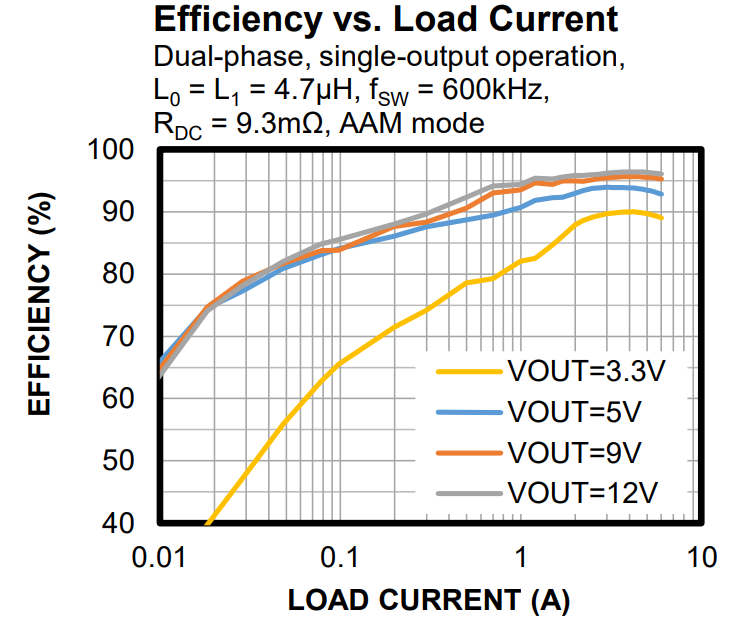

MP4317 | 45V, 7A, Low IQ, Synchronous Step-Down Converter with Frequency Spread Spectrum | MPS (7A max continuous for better efficiency and thermals operating at 5A continuous, capable of Vout = 12V given Vin = 19V - 24V)
MP8886 | 45V Input, Dual 3A/Single 6A Output, Digital, Configurable, Synchronous Buck Converter | MPS (Higher voltage input up to 45V for headroom, suggested to use dual phase 6A single output, characterized efficiency at Vout = 12V, see grey on efficiency curve below)
Best,
