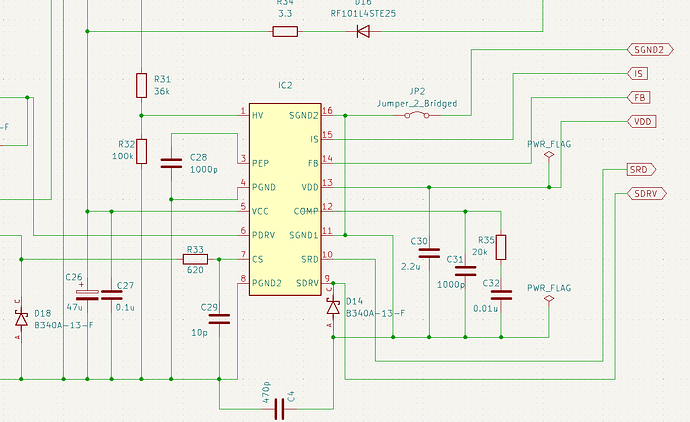

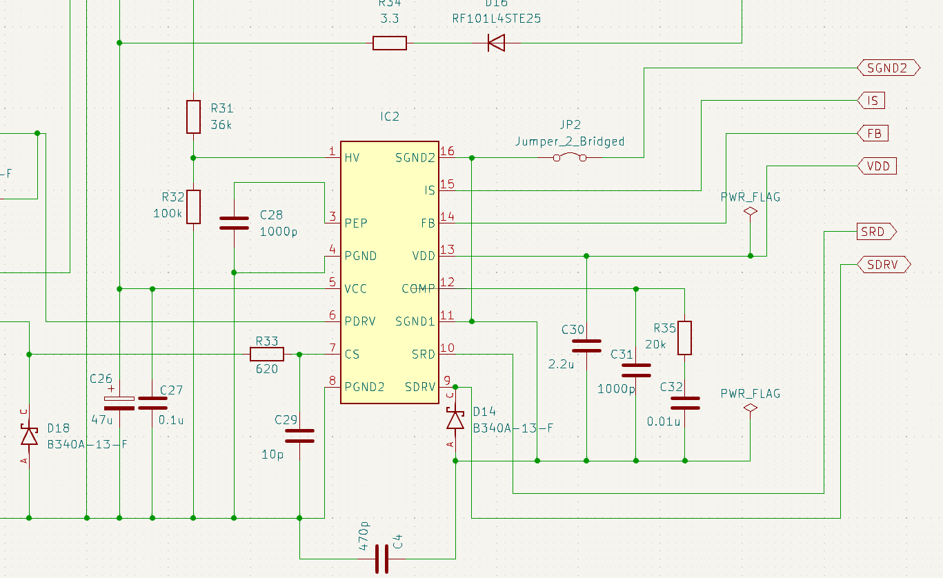

In the circuit below, the output will decrease as the load is increased.
The COMP value was calculated using MPX Excel.

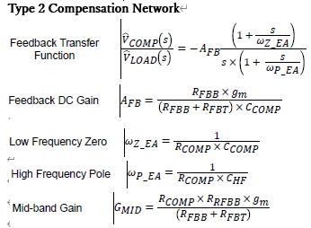

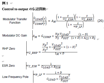

When calculating the COMP value, the transfer function for control to output is required.
I would like to know the values ​​of Gcomp and Acs for Modulator DC Gain AM in ①
I would like to know the value of A for Ri (=A*Rs) in Avc in ②
