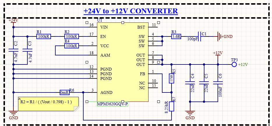

I am using the MPM3620GQV-P module in my project.
However, with or without load, the integrated temperature rises to 45-50 degrees.
İnput Voltage : 24V DC
Output Voltage : 12V DC
Max Output Current: 1A
Can you help me solve the heating problem?
I am sharing the schematic.

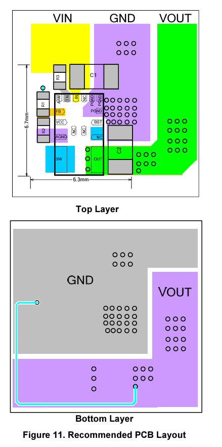

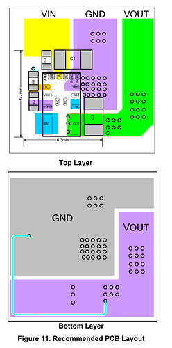

Hi @savasduran92,
Thermal performance most often related to the layout. I would recommend following the layout guidelines in the DS for better performance.
You can refer to the EVB DS as well for more information.
Thank you
