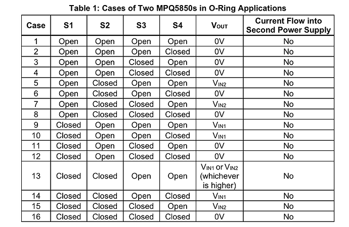

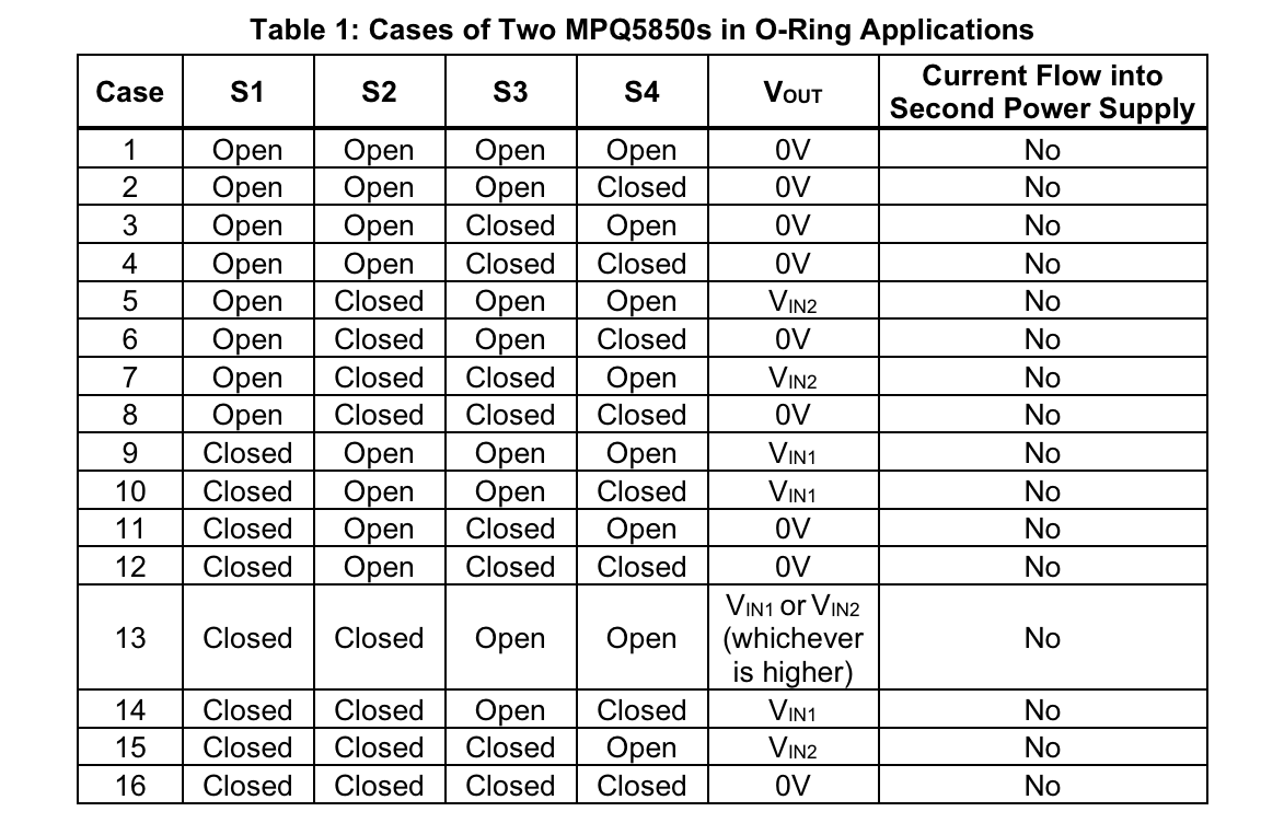

I am not sure we have one for that part. However, the attached App Note has a section in the PDF version that details or-ing on page 14.
AN185 - MPQ5850: 36V, Smart Diode Controller with Reverse Protection, AEC-Q100 | Application Note | MPS
Gracias, thank you so much! :slight_smile:
Do you have a similar application note that combines both or were you suggesting to just use MPQ5850 and a suitable N-Channel MOSFET?
Actually, your OR-ing proposal with the MPQ5850 does (as far as I can understand) an ACTIVE-PASSIVE configuration… I would like to have an ACTIVE-ACTIVE configuration (load sharing). Are there any MPS application notes implementing this with the aformentioned power requirements?
Furthermore, would it be possible to separate/isolate critical loads from non-critical ones? As in: if one of the PSUs fail, I’d like to keep part of the loads active no matter what and shutdown those deemed non essential?
