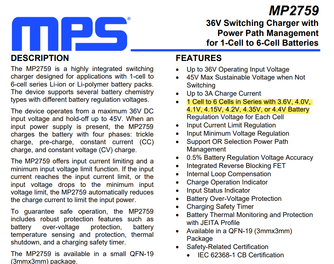

Is it possible to use a 2S2P pack (21700 cells, NTC and BMS) in combination with a MP2759?
Hello,
The MP2759 has a cell capability range of anywhere between 1-6 series cells. The typical cell voltage per series 21700 cell is 3.7V.
Do the following regulation voltages work for your application? If so, then I see no issue with using this battery charger.
